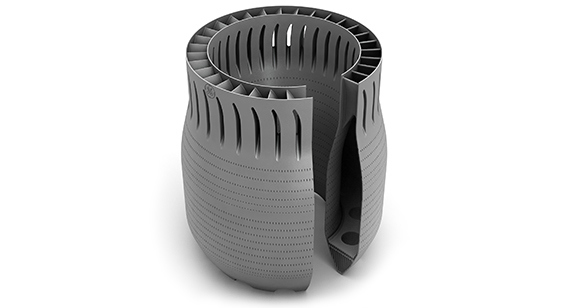

DMLM combustion liner
DMLM’s ability to build intricate geometries and lightweight designs makes is popular for aviation and aerospace applications, such as this combustion liner additively manufactured on GE Additive’s X Line 2000R.
