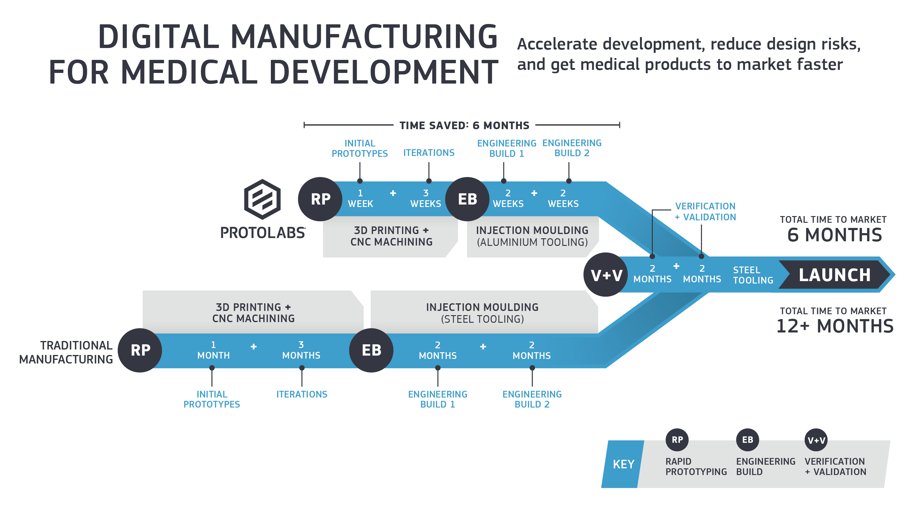

How can digital manufacturing support the Medical industry?
Precision is key when it comes to parts produced for the medical industry; however, being highly accurate is not the only requirement; parts also need to meet strict quality standards, including biocompatibility and serializability. This is on top of the demand for customised parts, such as individually tailored implants or anatomical models for surgery practice. Other key considerations include durability, chemical resistance and translucency.
There is a stark contrast between parts and quantities in the medical industry, highlighting its diverse manufacturing needs. Prosthetic and surgical device manufacturing represents a large portion of the medical industry, and these tend to be customised to the individual, but that is not to ignore the even higher percentage of mass-produced devices, including electronics, test tubes, liquid & gas injectors and sutures – Not forgetting the massive requirement for rapid medical device prototyping.
Why Do Medical Device Development Companies Use Protolabs?
Rapid Prototyping
Create prototypes in production-grade materials for functional and regulatory testing, or use our 3D printing service to print models and organ scans to preview before medical procedures.
Low-Volume Production
Ramp up production to get quality end-use parts to market fast and use batch production to reduce financial risk with no minimum order quantity (MOQ) and low total cost of ownership (TCO).
On-Demand Production
Build agility into your supply chain by ordering quick-turn parts when needed, regardless of what stage of development you’re in.
Quality Certification
Streamline development of FDA Class I and II devices, or non-implantable components, with moulding capabilities geared towards high-requirement applications and ISO 13485 quality certification.

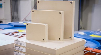

PEEK Material
PEEK is often used as a replacement for metal in the medical industry due to it being a lightweight material with good mechanical strength, fatigue resistance and high-temperature resistance (Protolabs' PEEK material - Victrex - can be used continuously at temperatures of 260°C). It is also very chemically non-reactive.

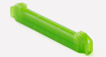

MicrofineTM Green
It is ideal for use in medicine  since it is possible to produce particularly fine, high-resolution structures such as; miniaturised catheters, a part less than a mm in size for a pacemaker and minimally invasive tools.

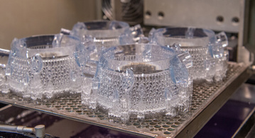

Watershed (ABS-like) is a clear material, which can be used to prototype microfluidic parts and transparent components like lenses and housings.
watershed parts
It's near colourless, clear appearance makes it ideal for flow-visualisation models, microfluidics and light pipes. The material is also water resistant and it's tensile strength and elongation at break are amongst the highest of 3D printed thermoset materials.
To achieve functional clarity, custom finishing is required.
