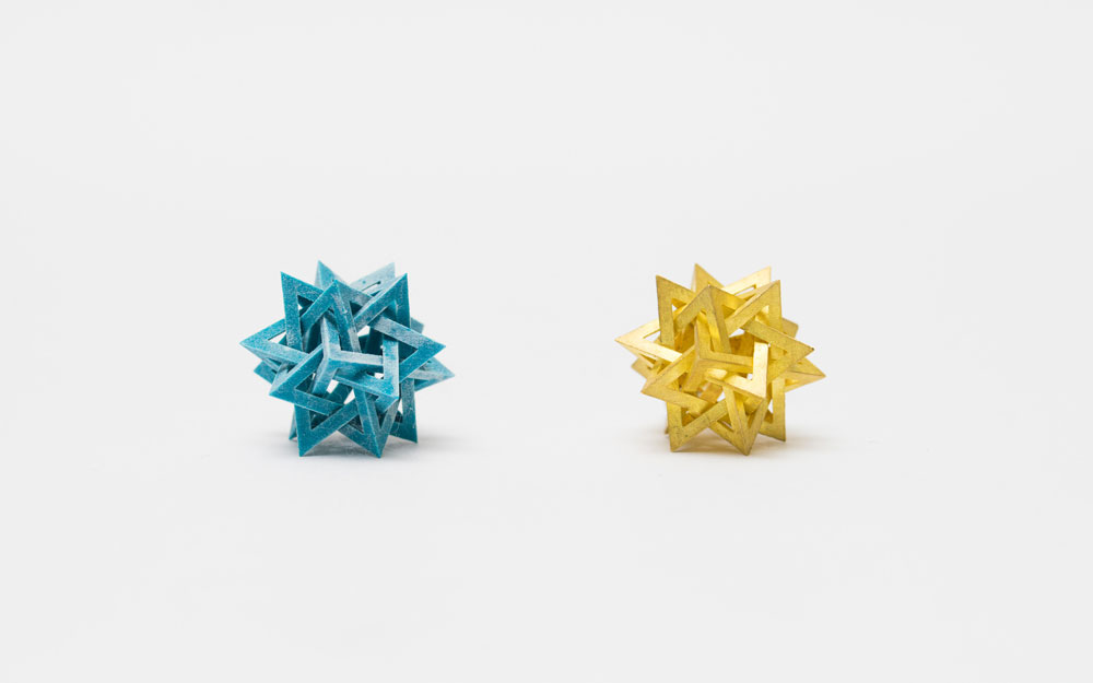

A 3D printed wax part (left) alongside the final cast gold part (right) (image courtesy of Cad Cast)

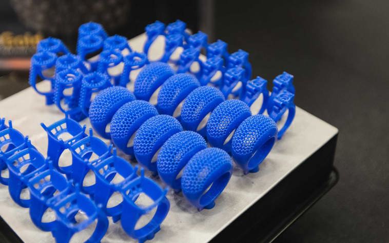

SLA/DLP: These vat polymerisation techniques produce smooth, high-detail parts from castable resins with low remaining ash percentages after burnout.

SLA and DLP printers allow a large number of parts to be printed in a single build

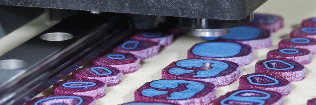

DOD: Drop-on-demand printing, a material jetting technique, deposits a wax-like material layer by layer, offering outstanding detail and dissolvable support for improved pattern surface finish.
  • Dissolvable support resulting in less post-processing and a better pattern surface finish
  • Patterns are printed with a wax-like material, meaning the pattern is melted rather than burnt out, eliminating the issues that arise with resin ash.

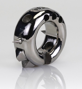

DMLS Custom Polish
Custom polished DMLS part

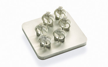

Metal 3DP JewelleryJewellery produced via metal 3D printing still attached to the build plate and showing support material
(image courtesy of Romanoff West)
