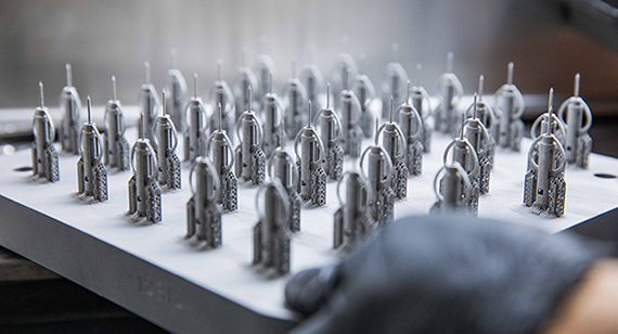

The fine features and complex geometries that can be achieved with metal 3D printing make it a valuable manufacturing process for highly-detailed medical components.
At Protolabs, we are seeing an increased adoption by our medical device partners of direct metal laser sintering (DMLS), the additive manufacturing process that 3D prints industrial-grade metal parts.
This is especially the case in the robotics, disposable instrumentation, and orthopedic segments. Our original equipment manufacturer (OEM) partners in the medical industry are constantly pushing the limits with metal 3D printing, challenging us and other outsourcing suppliers to advance and innovate within this process.
I’m pretty excited to report that we continue to develop this dynamic technology, which, in my opinion, is a game-changing process. Under the right circumstances, DMLS can be leveraged for medical devices, whether your product requires unique metal features, your own internal machining constraints are slowing down your launch, or other design challenges emerge. DMLS produces fully dense metal parts, often with an accuracy and surface finish that allow the part to go directly into service, making it a reliable 3D-printing process for end-use production of medtech products and devices.
