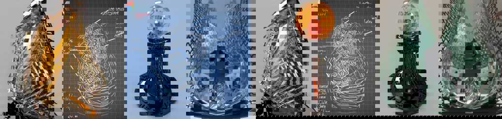

Not everyone could be a winner but honourable mentions went to the following for their submissions (shown in order above);
- Metamorphic Gem design by Sruthi Venkatesh
- Sebastiano Di Grazia
- Jeremy Webb International Torch of Innovation
- Bloom trophy design by Dionisis

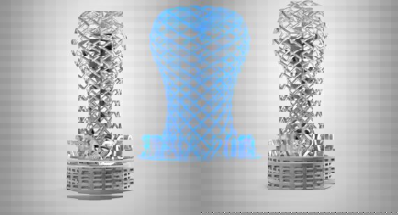

![Optim - 3DPI Trophy Winner](/media/1017822/optim-trophy-by-ferran-sánchez-monferrer-for-the-2019-3d-printing-industry-awards-1024x701.jpg?width=570&height=308&rnd=132084220823800000)
The winning design went to, Ferran Sánchez Monferrer for his Optim Trophy.
In his own words Ferran wrote this in support of his entry;
It 'shows all the possibilities that additive manufacturing has. The MJF piece is designed to show a lattice structure and a Voronoi diagram. These structures allow an organic finish and reduce the density of the construction. This design give an aesthetic finish that also allows easy construction and post-processing. The piece for SLA generates a diagrid on a surface that encompasses the entire central part of the MJF piece.'

Ferran: The name of the trophy is “Òptim”, it is a Catalan word that means optimum. My idea was projecting optimisation.
The optimisation of its construction and post-processing is what I was looking for when I was designing the trophy, without neglecting its aesthetic part. Therefore, the design not only seeks to use the advantages of additive manufacturing, it also tries to avoid its disadvantages of each technology.
In referring to the shapes of the trophy, the MJF piece was designed to focus on the most classic features that can be seen in a functional piece designed with this technology. For this reason, the design includes a Voronoi diagram for the tower and a lattice in its interior. The SLA piece is a diagrid that covers the tower.
