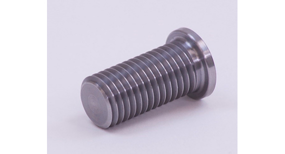

![CNC Machined Threaded Part](/media/7692/pldt-sep15-threading-short-draft1.jpg?width=570&height=308&rnd=131360057360230000)
2. Threading Decision
Instead of using a tap to cut internal threads, check that your supplier uses a thread mill to create the thread profile. It creates an accurate thread and a single milling tool can be used to cut any size that shares that pitch to save production and set up time.
To illustrate the point UNC and UNF threads from #2 up to 1/2in and metric threads from M2 to M12 are all possible from a single toolset. Find out more about threading here.
