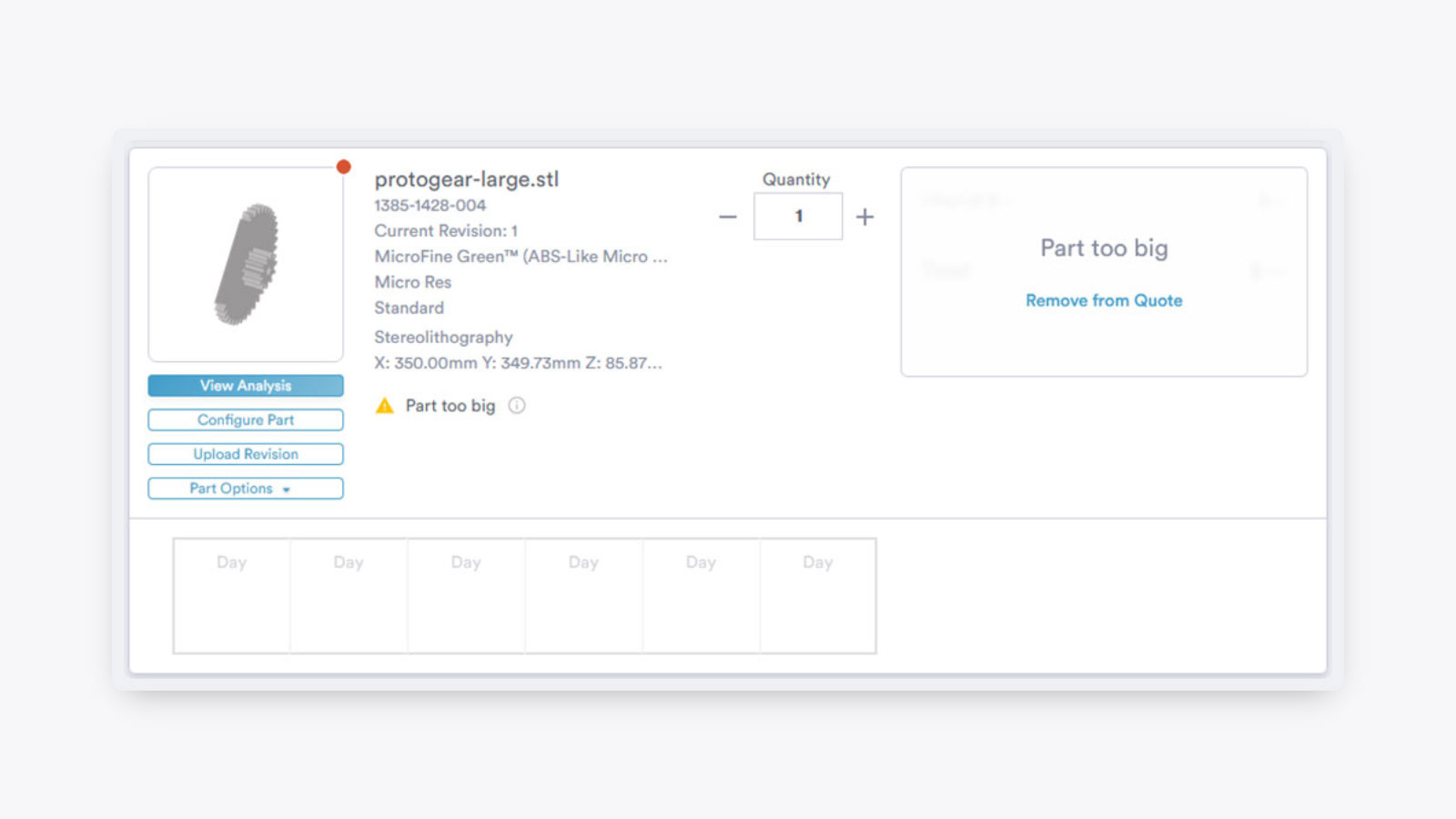

3D printed part too big advisory
At Protolabs, our machines allow for a wide range of sizes. We accommodate micro-resolution parts made from MicroFineTM Green, which can capably make parts that fit onto your fingertip, to our maximum size offered, which is 736mm x 635mm x 533mm for some of our other Stereolithography materials. To see max extents of all of our 3D printing materials, please visit our 3D printing toolkit.
Parts that are too small or large for analysis will show with a red circle, meaning that Protolabs cannot produce the part as it is and therefore is not quotable. In this situation, you can either phone up and discuss with an application engineer if you want support making your part manufacturable through our services.
