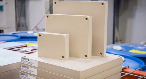

PEEK / pared with metal bearing surfaces
The go-to and do-all plastic for high-end aerospace, F1 and medical applications. PEEK has excellent sliding friction properties and offers high thermal stability, resistance to radiation, chemicals, hydrolysis and moisture, minimal thermal expansion and very low outgassing rates in a vacuum. It is recognised as having very high wear resistance for a plastic but also a high price! Its most common uses include sliding components, gaskets, guide rollers, chain guides in ovens, pumps, motors, turbines, water-lubricated compressors, gears and engine building.
