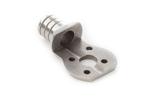

cnc titanium part
Aluminium
Aluminium is a crucial material in the space industry due to its light-weighting properties. It is often used as a building material for space shuttles, other space equipment, and engines.
Aluminium 2024 and 7075 are commonly used alloys in the aerospace and space industry.
2024 - Has a high yield strength, excellent fatigue resistance and good machinability. Often used in aircraft structural applications.
7075 - has a good balance of properties required for space applications, mainly where high static loads occur and low temperatures (cryogenic). Applications include fittings, gears, shafts and valves. It is often used in military applications.
Protolabs offers aluminium alloys in grade 2024, 5083, 6082, 7075 T651 and 7075 T7351
Titanium
Titanium's properties make it a popular choice for the space industry due to its high strength-to-weight ratio, good resistance to corrosion and high-temperature performance. Whilst aluminium has a lower density, Titanium's specific strength (strength to weight ratio), low thermal conductivity, high strength at elevated temperatures and good corrosion resistance often make it the first choice in engines and airframes, amongst other things.
Protolabs offers Titanium
