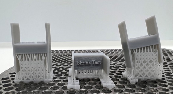

Do you need supports?
Supports are sometimes necessary; unfortunately, they will add production time to your print job. Supports will be needed if you have overhangs at more than 45° angles, although we often recommend keeping angles to less than 30° to avoid issues, especially if you are using thin, high walls. If there is a way for you to avoid tall, thin walls, large hollow areas or wider angles, then you will save yourself a lot of time.

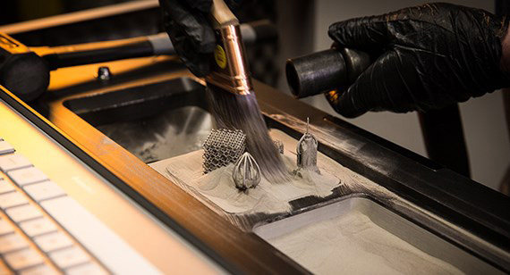

Let’s get straight to the point; if you can print your part using multi-jet fusion, you will get it back much faster than any other service. This, however, is very limiting on material options.
Does your part need to be made from metal? Or would plastic work? Plastic parts generally have a shorter build time than metal. This is due to the complexity of the metal printing processes and the fact that layer thicknesses in plastic printing can be much thicker.
