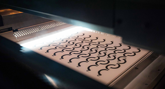

mjf machine

Consideration: Avoiding Overhangs—Unlike some 3D printing processes, MJF does not require support structures. The surrounding powder acts as a natural support.
