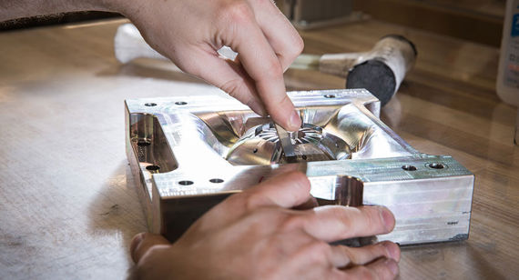

Finding a supplier that provides aluminium tooling and extra production capacity allows you to check your design through rapid prototyping of different iterations or to bridge a manufacturing gap to produce anything from 25 to 10,000 parts.
While aluminium tooling is more cost effective than steel and also has a faster turnaround, it still pays to get the design right. Consider the following factors to get the most from your design so that, when you are ready to opt for steel tooling, you have real peace of mind in an already proven solution.

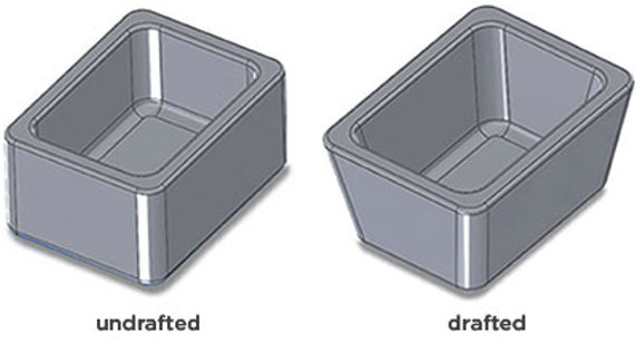

3. Don’t dodge the draft
Imagine your frustration if you can’t get the ice cube out of the tray for your gin and tonic. Fortunately, ice cubes have tapered and rounded edges (or draft) so that you can get them out easily.
It’s exactly the same with injection moulded parts, designing in a draft allows it to be ejected. Your part should carry at least 0.5 degrees of draft on all vertical surfaces and, if your design allows it then, 2 -3 degrees is even better. And if you have a heavily textured or complex surface, then you may need to allow 5 degrees or more.
Most CAD programmes can take care of this for you during part design as long as you understand how the part will be orientated in the mould. If you do miss the draft during your initial design, then your suppliers DFM analysis should pick it up.

Sharp internal corners are a problem for a couple of reasons. From a practical point of view aluminium moulds are machined using end mills so they are hard to achieve, but more importantly they tend to create stress and weaken the structural integrity of your part. We recommend being generous with your radii in part design.
