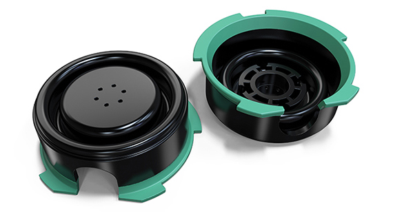

Med device overmoulding
Medical-grade LSR can be used for the full component, or in overmoulding, such as on this blood collection device made from polypropylene with a thermoplastic elastomer overmould.
