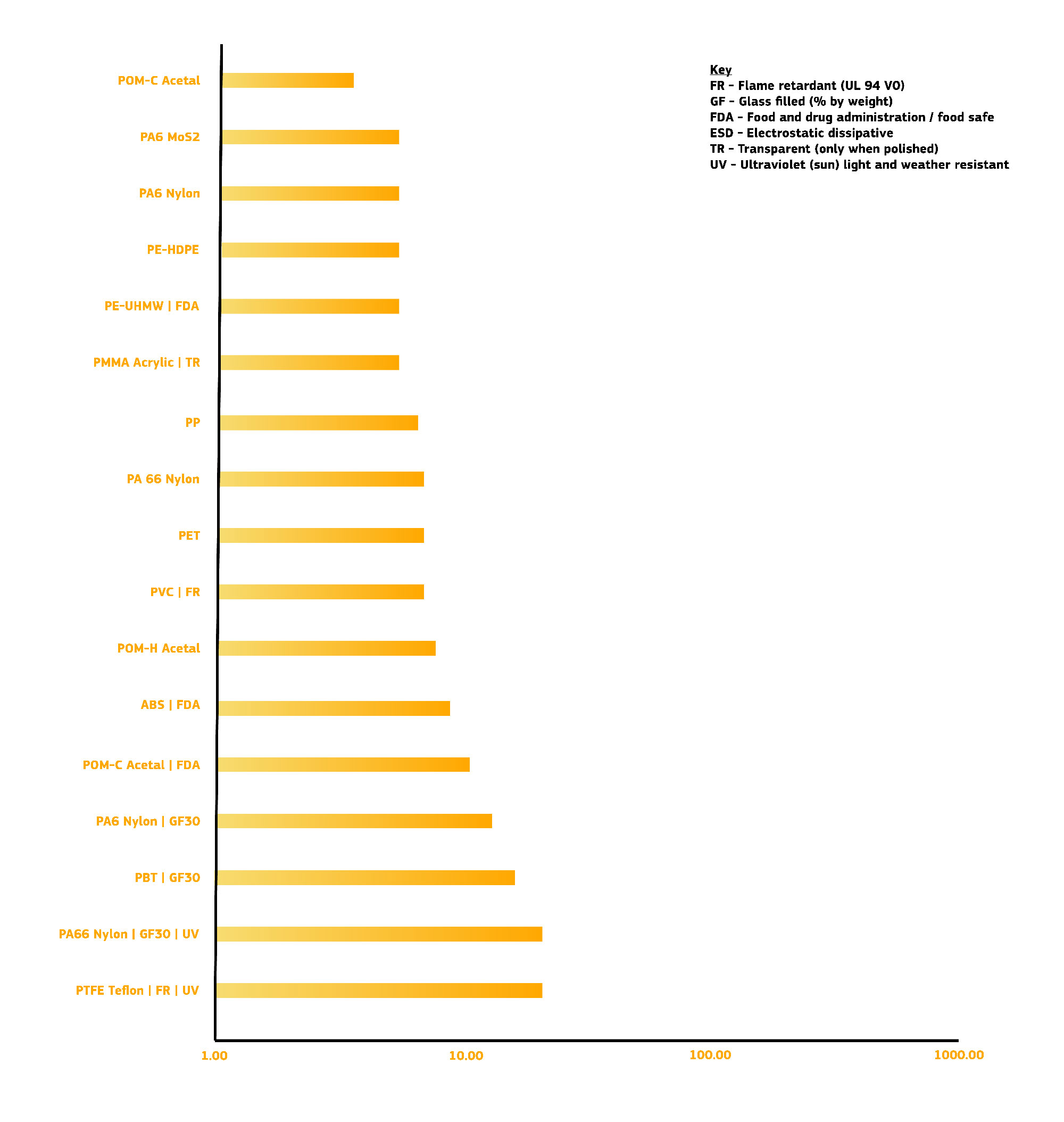

Plastics: on the other hand can look quite similar, but have an even more extreme price range.
  • Lower cost per kg: Nylon (PA6), acrylic and ABS are workhorse materials; used extensively in injection moulding as well as CNC components. However, there is a material that may work out both cheaper and have better performance. Acetal (often referred to a Delrin®) is a great general purpose engineering plastic with good stability.
  • Medium cost: You will pay about 50% more for glass-filled grades – the brittle but fragile properties of glass fibre, combined with the tough plastic, creates a composite. Which is stronger and harder wearing.
  • Specialist: these raw materials exceed the price of titanium (can be over £100/kg) so worth checking if you can use an alternative first! Generally they are required to meet a specific need: PC (polycarbonate) is so strong it is used for bullet proof glass! PEEK – the go-to choice for F1 and aerospace, stronger than some metals, UV and flame resistant it can cope with almost any demand. PSU, PPSU, PEI are generally used in food and medical applications. Finally, POM-ESD is modified to be just conductive enough to prevent static discharge.
