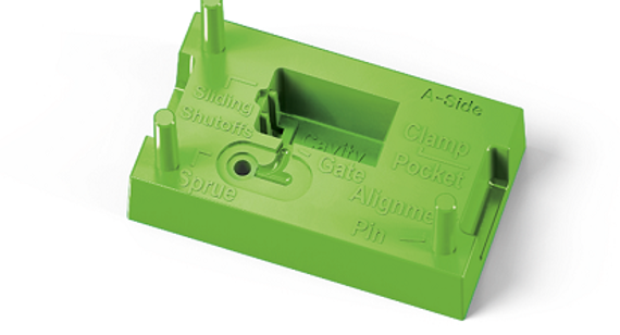

![Protolabs Demo Mould Mould A-Side](/media/jq1e5k0i/mouldaside.png?width=570&height=308&rnd=133487292903900000)
Mould A-Side
Cavity – the void or negative space within the mould that forms the desired shape of the product being manufactured. Essentially the inverse of the final product. When molten plastic is injected into the mould, it fills the cavity to take on the specific shape and dimensions of the finished product.
Clamp Pocket – a feature within the mould that assists in securely holding or clamping the mould halves together during the moulding process.
Leader Pin – Used to align and guide the two halves of the mould together during the closing process. These pins are typically cylindrical and are located on one half of the mould, fitting into the holes on the opposite half.
Locking Wedge Interface – a mechanism used to secure and tightly seal the two halves of the mould during the injection process. Prevents any mould misalignment or movement whilst the material is injected into the cavity.
Sliding Shutoff – a component within the mould that allows for the creation of undercuts or complex features in the moulded part. It’s used to create internal or external details that cannot bee formed with a simple two-part mould.
Sprue Hole – a channel or passage within the mould that allows molten material to be injected into the mould cavity. It’s the entry point into the cavity.

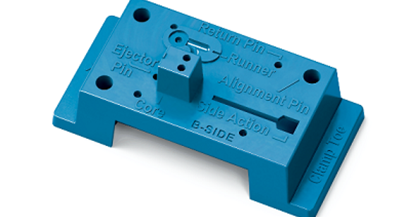

![Protolabs Demo Mould B-Side](/media/wpuofboq/mouldbside.png?width=570&height=308&rnd=133487292900000000)
Mould B-Side
Clamp Toe – the area where the clamp force is applied to, in order to ensure the mould remains closed during the injection process.
Core – one of two main components used to create a desired shape. The core is the part of the mould that shapes the internal features of the final product. It is the interior surface of the part and creates voids, holes and other internal details.
Ejector Pin Holes – small cylindrical recesses or openings in a mould that accommodate ejector pins.
Leader Hole – hole used for aligning or guiding components during the assembly or disassembly of the mould.
Return Pin Hole – accommodates the return pin. The return pin is used in moulds with moving elements like slides or cores, to retract or return these elements to their initial / starting position at completion of the mould cycle.
Side-Action – also known as sliders, lifters, or side cores, are movable components within the mould that create features on the part that would otherwise be impossible or difficult to form using a two-part mould. These side-actions move perpendicularly or at an angle.
Side-Action Track – path or guide along which the side-action components move within the mould. The tracks are designed within the mould to facilitate the controlled and precise movement of the side-actions.
