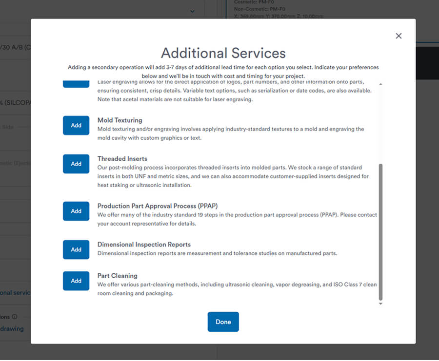

Our standard offer PPAP is comparable to a traditional level 3 PPAP. For this, we use the information you supply to us. The form includes basic information about the part and process used at time of quote and order. The PPAP includes results of the customer-chosen inspection options, identifying the dimensional requirements of your part. Check out this sample of our PPAP package
Our PPAP contains several of the traditional 19 elements that will show the repeatability and reliability of processes used to produce your part. Standard PPAP-included items are process flow charts, PFMEA, control plans, inspection plans, dimensional results, certificates of conformance, and part submission warrants. We retain batch records for sample production parts, and master samples with your mold. Part-specific analysis containing DFM with associated risks is provided with every quote. Our standard PPAP has minimal impact on your quoted lead times.
If you have additional needs, selecting a custom PPAP through our additional services selector will initiate a review process by our team where we can use an external certified inspection provider. Our team will work with you to gather specific requirements. Note that custom PPAPs require additional lead time. This additional lead time will be quoted at the time of the part order, and is typically 3-5 business days, depending on the PPAP level.
