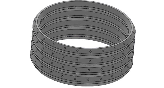

Diamond Seal CAD
A CAD model of a critical element in the ETIP tool. The accordion-like structure allows the packer system to be deployable and retrievable.

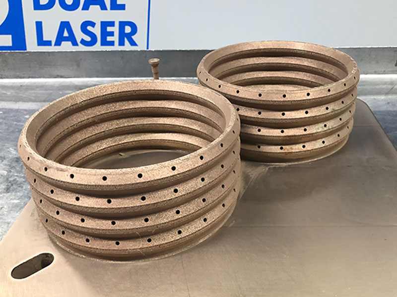

Other smaller parts made on GE Additive M2 machines were expansion rings. Some were single and others were stacked up together as one part in smaller pieces. The rings were printed in stainless steel 316L and some in 17-4 iterations. Each part was solution annealed and cut off from the 3D printer using electrical discharge machining (EDM). The 17-4 parts, specifically, went through H900 surface hardening.
