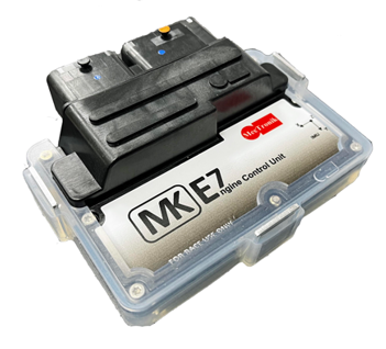

Talking about the project Claudio says, "There was a need to build a lightweight, heat-resistant and high-quality anti-vibration mount without increasing the size of the ECU. One with a complex design yet manufactured in small volumes."
Following the request from Mectronik, Protolabs created an initial prototype of the ECU holder in fake silicone using polyjet 3D printing technology in just a few days. This first prototype was to validate the design and mechanical characteristics of the part.
Stefano Mosca, Protolabs Senior Account Manager said: "The continuous flow of information between us and Mectronik ensured that we were able to optimise the design of the part and start production of the mould ready to produce the parts within a few days. Having the material needed to meet the customer's performance requirements also played a major role, as at the time it was not readily available".
Following prototyping and testing, Protolabs used injection moulding to produce the parts from liquid silicone, which is a soft elastomer that dampens vibrations and is temperature resistant. The mould was made from aluminium using CNC machining so it was produced quickly ready for the production of the 250 parts required by the customer.
