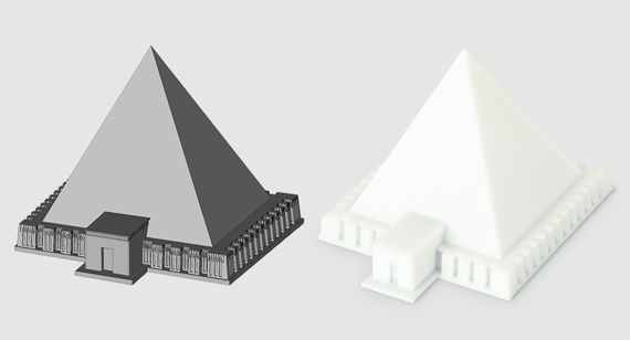

He chose Protolabs’ industrial 3D printing services for several prototype iterations. These prototypes would help bridge the 3D virtual models into the final physical models, which, essentially, are moulded-cast epoxy models based on the 3D prototypes. The prototypes themselves, using the additive manufacturing process of stereolithography (SL), were made of an ABS-like thermoplastic.
Street says that as he worked through those several iterations in the prototyping phase, he was especially pleased with Protolabs’ speed—getting parts back in days rather than weeks or longer—and the prototype parts’ level of detail. “It enabled us to get our parts back quickly. It would have been far more difficult to build the piece by hand than it was to model it in the computer and extract the parts I needed.”
“The detail of the 3D-printed part—it would have been very difficult to achieve that type of exacting geometry without the use of 3D printing.”
Stereolithography produces fine details with ABS-like thermoplastic material.
A CAD model of the pyramid was initially created as an .STL file (left), then built in SL out of a white ABS-like thermoplastic material (right).
The level of detail of the prototype parts was especially beneficial, Street says. “The detail of the 3D-printed part—it would have been very difficult to achieve that type of exacting geometry without the use of 3D printing.” Protolabs’ stereolithography (SL) process is especially suited for these types of projects that call for small parts with complex geometries and precise patterns.
