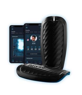

The result, XSEED are smart shin pads that can record both athletic data such as distance run, maximum speed, numbers of sprints and acceleration as well as technical data such as the number of passes, crosses, shots and shot power. It’s ability to record and geolocate events on the game’s playing surface is a key breakthrough.

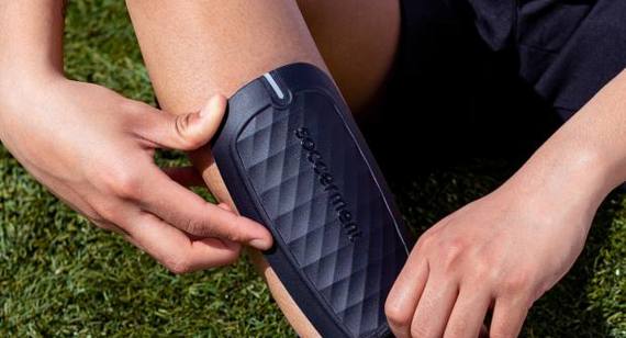

The company’s challenge was to develop a shin guard that has a frame that houses two accelerometers, a gyroscope, magnetometer, GPS antenna, Bluetooth module and its battery, all weighing less than 100g. It also had to be PPE certified and meet strict regulations for its mechanical strength and pass a number of tests to secure CE certification.
After Protolabs tested a number of materials, Soccerment chose a black polycarbonate-siloxane co polymer. Protolabs then produced prototypes using rapid injection moulding ready for mechanical and design testing.
In addition, Soccerment also needed an opaque material to produce a light guide for the LED at the top of the shin pad. Protolabs suggested a natural white translucent nylon refined through embossing, a solution that they had developed for another customer Befreest, and then assembled this directly onto the frame using its secondary gluing service.
By working with Soccerment in the initial design phase, Protolabs only manufactured two moulds to produce four different pieces, the right and left shin guards and the right and left light guides. This helped keep the production cost down for the startup company.

XSEED is now an essential smart wearable in football. It allows teams and clubs to monitor all biometric, performance and field positions of players in both training and matches. The Soccerment portal can receive and reprocess thousands of data inputs and visualise and make them usable immediately. Ultimately this data will help clubs make better more impartial footballing decisions.
