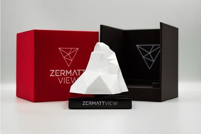

Obtaining a mirror polished finish at the end of the mould
Move closer to ZERMATTVIEW and you'll see your own reflection on the Matterhorn because of its smooth surface. This result was of course a non-negotiable requirement for Eddy and Joachim. This is obtained right from the mould, without any subsequent reworking, thanks to the right choice of material and Protolabs' know-how in mould preparation.
"For ZERMATTVIEW, we have chosen a high quality ABS grade and a class A finish according to SPI standards, which is similar to the mirror polish of a car body. Our moulds are polished by hand, by highly skilled people, until we achieve the desired surface finish", explains Thibaut Jeannerot, Application Engineer at Protolabs. "In every project where aesthetics are paramount, it is essential to get everyone on the same page. Because aesthetics is a matter of subjective opinion. At Protolabs, we always validate this dimension with a few dozen or even a few hundred samples, depending on the size of the series under consideration", he adds.
“Our moulds are polished by hand, by highly skilled people, until we achieve the desired surface finish".
Elegantly housed in its own case, ZERMATTVIEW is currently on a tour of the shops on Bahnhofstrasse. There is no doubt that it will soon take up residence in several of them.
