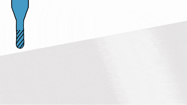

1. The ‘Hole’ Truth
Anyone who has spent more than five minutes in a machine shop knows what a drill bit looks like and what it does. For the most part, however, holes at Protolabs are interpolated with an end mill rather than drilled. This machining method provides great flexibility in terms of the hole sizes available with a given tool, and offers better surface finish than that obtainable with a drill. It also allows us to use the same tool for machining slots and pockets, reducing the cycle time and part cost. The only downside is that holes more than six diameters deep become a challenge due to an end mill’s limited length, and may require machining from both sides of the part.

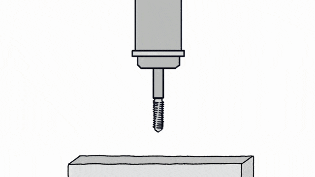

2. Threading Right
Drilling and thread-making go hand in hand. Many shops use “taps” to cut internal threads. Taps look like a screw with teeth, and are “threaded” into a previously drilled hole. We take a more modern approach to thread making, using a tool called a thread mill to interpolate the thread profile. This creates an accurate thread, and a single milling tool can be used to cut any thread size that shares that pitch (the number of threads per inch), saving production and setup time. Because of this, UNC and UNF threads from #2 up to 1/2 in., and metric threads from M2 to M12 are possible, all within a single toolset. (Learn more about threading here.)
