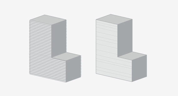

illustration of surface finish on DMLS part
On a vertical or horizontal surface, direct metal laser sintering (DMLS) produces part roughness about equal to a sand casting. All other surfaces will see some amount of stair-stepping (as seen at left). If your part design requires a smooth finish, that stair-stepping will need to be blasted, sanded, or machined (as seen at right).

Another reason for combining DMLS and machining is surface finish. On a vertical or horizontal surface, DMLS produces part roughness about equal to a sand casting. All other surfaces will see some amount of stair-stepping, an effect that’s largely dependent on how the part is situated in the build chamber. If your part design requires a smooth finish, it will need to be blasted, sanded, or quite possibly machined. This last part is no big deal, unless your part design calls for a fine finish on a surface that the end mill, drill, or turning tool can’t reach. Whatever the case, be sure to call out such critical features on your CAD model when submitting to Protolabs, so the features needing secondary processing, including machining, can be identified.

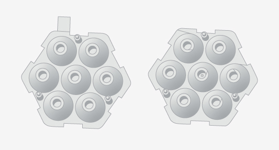

CAD model of 3D printing DMLS fixturing
Oftentimes, fixturing printed parts is necessary, which involves adding a tab or other device to the CAD model itself and printing it directly onto the part, as seen here. It can be removed after machining.

Unlike DMLS, which requires nothing more than a simple “build plate” to carry the workpiece through to completion, machined parts must be clamped, bolted, or otherwise securely fixtured to the machine to prevent cutting tool-induced movement. If your 3D-printed workpiece is composed entirely of curved, organic shapes (which is one of 3D printing’s greatest appeals), how will the machinist hang on to it for turning or milling? Check with an applications engineer at Protolabs, but you might need to design in a pair of parallel surfaces or some mounting holes by which to clamp the 3D-printed workpiece for machining.
