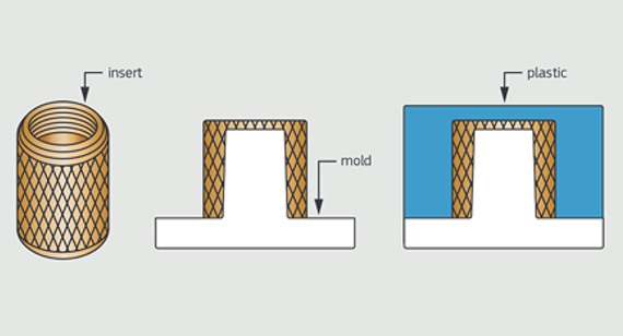

But where overmoulding is a two-step process, requiring one shot for the substrate and another for the overmould, insert moulding is, as an industry saying goes, “done in one.” The threaded insert, bushing, sleeve, or boss is manually placed into the mould, the mould closes, plastic flows, the mould opens, and the part is ejected. The result is improved part strength and reliability.

insert moulding illustration
A threaded insert is placed atop a mould core where plastic is moulded over it to form the final component.
