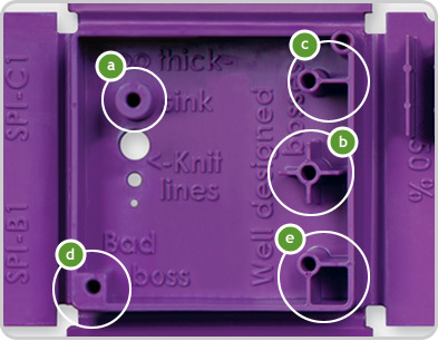

![Boss examples in design cube](/media/7764/bossesfig1.jpg?width=570&height=308&rnd=132944148355830000)
Boss Configurations Vary
A typical boss is an open-topped cylinder, essentially a round rib (see figure 1a). Standard guidelines suggest that its wall thickness be between 40 and 60 percent of the thickness of the wall from which the boss rises. If your design requires more strength than this guideline would provide, you should consider ways to strengthen the boss without thickening its walls. The most common of these is to surround the boss with gussets to support and strengthen its walls (see figure 1b).
If a boss is part of a vertical wall, it should not create a thick area in the wall. Figure 1c shows an example of how this can be done. Similarly, if a boss is located close to a vertical wall, it may be tempting to tie the boss to the wall by filling the space between the boss and the wall, resulting in a thick area (see figure 1d). A better way to tie the boss to the wall is with one or more ribs (see figure 1e).
