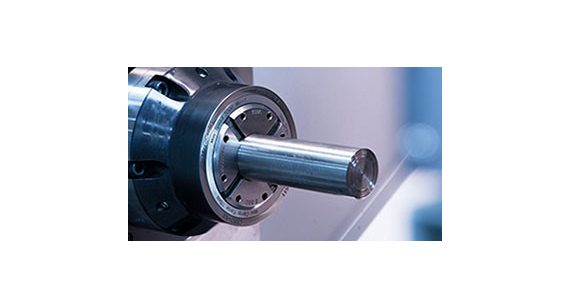

Here are some of the reasons why our CNC machining service has turned to, well, turning. By adding live-tool (end mill) equipped CNC turning centres to our already extensive three-axis milling service, we’re able to produce better surface finish on cylindrical features and at a typically lower price for customers. Lathe also makes more efficient the manufacture of those parts that may skate on the edge of our milling capabilities. And if the goal is eventual low-volume production, turned parts are good candidates.
![Metal rod stock on lathe](/media/7758/turning-to-lathe-for-cylindrical-parts1.jpg?width=570&height=308&rnd=131363585100600000)
Have a design concept for the next best camera lens housing? How about a revolutionary drive shaft for a lawnmower, one with milled flats and threaded cross-holes? Chances are, we can deliver a turned prototype for that geometry.
Turning parts such as these offers several advantages over milling. As implied previously, long length to diameter ratios on pistons and shafts give mill operators an upset stomach. Turning a set of candlestick holders for your Aunt Martha’s 60th birthday, however, is a piece of cake on a lathe.

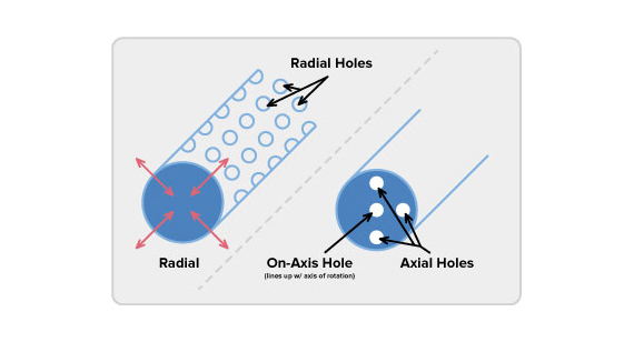

As mentioned earlier, our new lathes have milling capability. Drilling a side hole or milling a flat is well within their means, as long as that feature is parallel or perpendicular to the long axis of the part. No angled holes yet, sorry. Any milled grooves should be wider than 1.2mm, but because all of our lathes are equipped with a Y-axis, we can machine slots or holes off-centre (within reason).
Need your company’s name engraved on the parts? Indented text is best with milling, but on a lathe raised text is best. We can machine most any lettering as long as the line width and character spacing measures at least 0.5mm across. Small holes don’t scare us off, nor do threads. In fact, we’ll drill radial holes down to 2mm and axial holes half that size. Likewise, we support a range of internal and external UNC, UNF, and metric threads.
