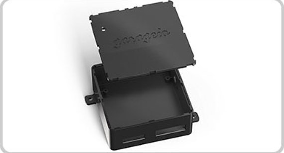

Self-mating parts live throughout the manufacturing world, often seen in handheld medical devices, television remotes, computer router casings, children’s toys, and pretty much any industry you can think of. Some have completely symmetrical halves, but many do not. Garageio, for example, makes systems that let users control and monitor their garage doors via smartphones. The central communication hub (see Figure 2) is a compact black box that affixes inside a person’s garage. The team at Garageio and an applications engineer (AE) at Protolabs worked together on a design that incorporated an interlocking system of drafted tabs and clips that allowed the top cover to firmly self-mate to the bottom half of the box.
