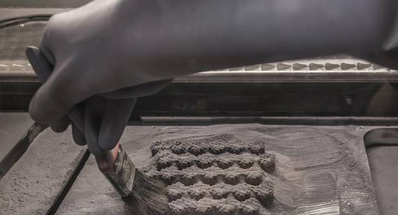

Technician brushes away powder
Metal powder is brushed away from a bed of intricate aluminium parts.

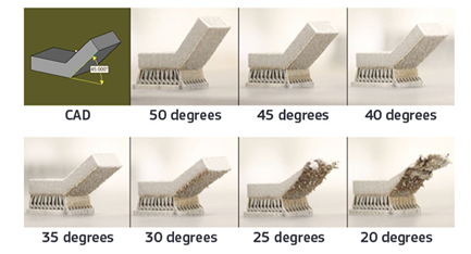

Self-Supporting AnglesImage of self supporting angles for dmls 3d printing
A self-supporting angle describes the feature’s angle relative to the build plate. The lower the angle, the less the likely it is to support itself. Each material will perform slightly different, but the general rule of thumb is to avoid designing a self-supporting feature that is less than 45 degrees. This tip will serve you well across all available materials. As you can see in the picture above, as the angle decreases, the part’s surface finish becomes rougher and eventually the part will fail if the angle is reduced too far.
