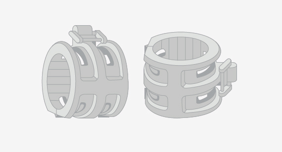

WHY 3D PRINT JIGS AND FIXTURES?
  • Irregular or complex shapes
  • Small tooling
  • Parts that are difficult to machine
  • Multiple parts
3d printed additive part for jigs and fixtures
For jigs and fixtures with irregular or complex shapes, 3D printing can be an excellent complement or alternative to machining.
