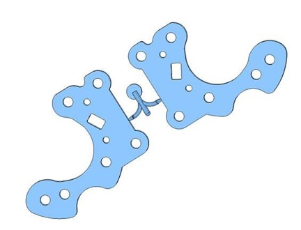

Did you know that you could save yourself up to 40% of your costs if you identified parts that can be injection moulded as a family in the same mould?
Family parts, just like other multi cavity parts, share the same mould. Since a lot of the cost of injection moulding is in machining the mould, then putting two or more parts into one will be quoted as a single part instead of multiple parts. It won’t quite be two for the price of one, because there are other considerations, but you will still make a substantial saving.

The injection moulding cycle time is usually dictated by the part size and thickness. If one part is bigger or thicker than the other, then their cooling times will be different, and this could affect part shrinkage. You may also have a filling unbalance between the two parts leading to potential defects.
It means that for a family mould to work, you need parts that are a similar size and have a similar geometry.

For the former Pin style and hot tip gates are often used to help solve challenges with complex part geometries and reduce gate vestige – the small remnant of runner material that must be trimmed from the finished workpiece.
These are rarely if ever used on family moulds. Here edge gates are the better option, because you have far more flexibility in where to place it, which is vital when trying to squeeze multiple parts into a mould. It also has a larger vestige, which might mean that more trimming is needed, but crucially this helps absorb residual flow stress around that section of the mould.
Gate placement is also important when you are creating a multi cavity tool and something that you need to aware of if you are considering sharing parts in one mould. We would not recommend designing your own runner and gate system, but instead work closely with us to achieve what you want.
