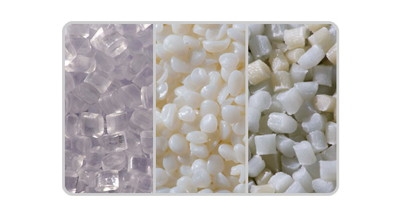

Injection moulding base resins
Figure 1: Base colour resins in their original pellet form. Left to right: acrylic (clear), ABS (natural), and glass-fibre nylon (natural).
Injection-moulded parts, for all their many shapes and sizes, all start out pretty much the same—as small plastic pellets. The base colours of those pellets vary somewhat depending on the resin, but they all fall somewhere on a monochromatic scale from clear through various shades of natural to black (see Figure 1). Turning those dull little pellets into the rainbow of colours that comes out of moulding presses requires the addition of colourant, which can be a fairly simple or fairly involved process. The complexity depends on how particular you are about your colour.

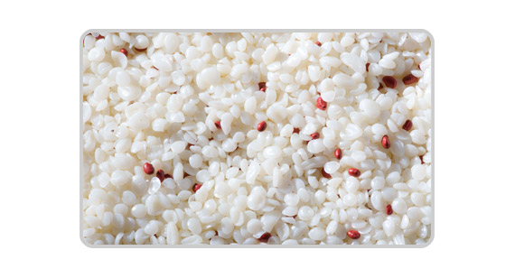

Colourant mixed with base resin to create final coloured part
Figure 2: Typically colourant is mixed into base resin at 2% concentration to create coloured parts. This photo shows a 2% colourant mix.
There are basically two ways to get coloured injection-moulded parts. The simplest is to mix dye pellets into a batch of base resin pellets (see Figure 2). As the pellets are heated and compressed for injection into the mould, the base resin and dye pellets melt and mix together before being injected into the mould. The other way is to order pre-compounded pellets in the exact colour you want; for example, a standard PMS colour or match to a sample swatch.

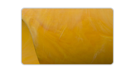

3. Because dye pellets are mixed with base resin pellets in a “salt and pepper” mix, there is a chance of "swirling” in the resulting parts (see Figure 3). The degree of swirling depends on a number of factors. “Hot” colorants—red, orange, yellow—tend to exhibit a higher swirling risk than cool colours like blue and green. Also, large parts, because they use more of the contents of the chamber in which resin pellets are melted and mixed, are less likely to show swirling than small parts.
4. Unless you use pre-compounded coloured resins, there is a risk of inconsistency from lot to lot and from part to part. This is one of the reasons that we recommend our standard ratio of two percent (2 %) colourant.
Injection-moulded nylon sample with swirling colourant
Figure 3: Sample of swirling effect from a nylon material with yellow colourant. Choosing a pre-compounded resin would have helped the customer avoid this issue.
