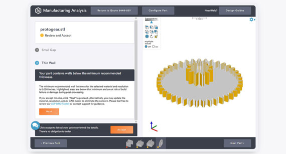

Jumping the Gap
Now take a look at the Small Gap warning in Figure 2. This indicates that the distance between each of the spur gear’s teeth is less than the recommended 0.75mm, and that, depending on the 3D printing process, raw material, part geometry and orientation, the customer can expect partial or even complete fusing between some or all the teeth.
Screenshot of Protolabs platform
Figure 3
Here’s one place where micro-resolution shines. As noted earlier, it supports features down to 0.07mm in the horizontal direction, one-half and one-fourth the size of high- and normal-resolution respectively. This statement also holds true for the Thin Wall warning seen in Figure 3. In this situation, the as-printed teeth might not meet the desired dimensional or geometric tolerances and could even break off during printing. Micro-resolution SLA and high-resolution direct metal laser sintering (DMLS) are the best option in each of these cases, size constraints notwithstanding.
