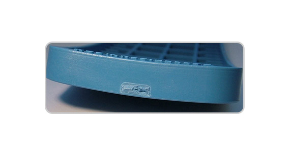

Tab Gate Option
Tab gates are effective and most common, but not necessarily pretty. (See Figure 1.) While they are a simple way of getting resin into the mould cavity, tab gates have several drawbacks.
- First, they carry resin to the mould via a runner. Because this allows some cooling and thickening of the resin, tab gates require a relatively large opening into the mould cavity. This, in turn, leaves a large tab to be trimmed, a process that can mar the finished surface.
- Second, the runner leading to a tab gate takes up real estate within the allowable mould footprint. This can be a problem if the part pushes the limits of allowable mould size.
- Third, because resin cools somewhat on its way to the gate, there are potential mould fill considerations like uniformity, concentricity, knit line formation, thin feature challenges, etc.
- Finally, tab gates must be located at the parting line of the mould.

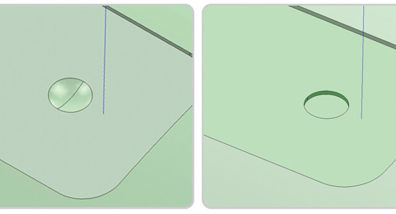

Hot Tip Gate Option
In many cases, the solution may be a "hot tip" gate. A hot tip gate has a small circular gate opening in the "A" side of the mould that lets plastic into the cavity. It's called a hot tip gate because there is a thermostatically-controlled heater bolted to the back of the mould to keep the resin hot enough (and thus fluid enough) to pass through the small gate hole.
The hot tip can be thought of as a direct extension of the moulding press's barrel and screw. Resin is hotter at the point of injection, so the opening can be smaller. Because no runner is required, the part can use virtually all of the allowable mould X-Y real estate. Hotter resin also means material may be pushed further into a thin feature.
Hot tip gates are typically located at the top centre of a part (as opposed to on the parting line, as is the case with a tab gate) and are ideal for round or conical shapes where uniform flow can improve concentricity. The hot tip gate leaves a small raised nub on the surface of the part. Adding a hot tip dimple to your design may help shift the nub below the surface of the part, which might allow something like a decal to be applied over it with little or no need for trimming beforehand.
![Two versions hot tip dimples](/media/1012054/gates-2-horizontal.jpg?width=570&height=308&rnd=131581676616330000)
Hot tip dimples are usually 0.125 to 0.375 inches in diameter and 0.010 to 0.030 inches in depth. This can take the shape of a spherical or cylindrical depression. (See Figures 2 and 3). To maintain the always desirable uniform wall thickness, you could add material to the opposite side of the part so the material is not restricted in flow.
Be sure to consider that the "A" side of a part is usually the externally-facing cosmetic side, which means if you use a hot tip, the gate vestige ("nub") is likely to be visible in an assembly. As noted above, a hot tip dimple is a common method of trying to help hide the nub and should be considered when selecting decal locations on high cosmetic parts. Also be aware that some materials such as acetal and glass-filled resins are not compatible with hot tip gates, and that small volume parts may be problematic because of the tendency of resin to "cook" in the hot tip longer, potentially degrading its properties.
When asking for a hot tip gate, you should also consider the extra expense of installing a hot tip gate, such as the features that need to be machined into the back of the "A" side mold half. In addition, once a hot tip gate is used, it is much more costly to modify the mold. For example, there is no simple way to move a hot tip without completely re-making the "A" side of a mold.
