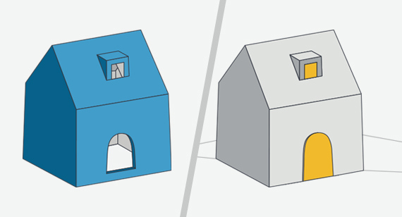

To take a closer look at shut-offs—a design element that allows engineers to solve difficult tooling and design issues—let's consider the injection moulding of a box. The box looks like an A-frame house with four vertical walls and a roof. On one of the vertical walls there is a cut out that would resemble a door and on the roof there is a dormer with a window. See Figure 1a.
The A-side is the exterior of our box and the B-side is the interior core. Figure 1b is the B-side of the mould. In order to create the door and dormer window, the faces of the mould must slide past each other until the mould closes where they create a seal which creates a hole in your part. These are the shut-offs, shown in red in Figure 1b.
Shut-offs Help Create Part Features
Shut-offs in straight-pull moulds will allow you to design many different features that fall in to three basic categories: Holes, hooks, and long through holes without the use of side-actions (cams).
In the illustrations shown in this tip, you will see several design examples. Let's first go back to the box-like "house" part example. Figure 1A shows the door in our box, or a hole in the wall. The door is formed by a pad that lives on the B-side core (Figure 1B). The pad is the same thickness as the wall section of the part and seals against the vertical wall of the A-side cavity. If this seal is damaged or wears too aggressively, the plastic will sneak past the seal and create flash. The dormer window on the roof of the part is formed the same way, but shows this form of shut off surrounded by plastic.
Shut-offs require greater draft to reduce the amount of wear on the mould and form a better seal under clamping force during moulding. The minimum draft of 3 degrees allows greater clearance for the sealing faces on opposite sides of the mould to pass by one another without the risk of gouging and wear.

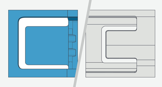

![Undercut for moulded part illustration](/media/1013573/clip-of-a-complex-injection-molded-part-570x308.jpg?width=570&height=308&rnd=131662722769370000)
The final set of illustrations, Figures 3A and 3B, include a top down view of a clip. This image shows the space in between the clip and the pull-through core to build the shut-off. This component part is just a small section of a much larger complex part.
Shut offs are powerful tools that allow creative designers and engineers to solve difficult tooling and design issues using drafted walls sealing against drafted walls, eliminating the need for post-moulding machining or the need to remove functional geometry.
