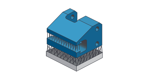

Just because the metal is suitable for end-use parts doesn’t mean DMLS is the right process to build them, however. DMLS uses a high-power laser to melt and fuse metal particles one paper-thin layer at a time. Because of the extreme heat involved, warp and curl must be controlled using scaffold-like support structures, which have to be removed after the build process. This additional time and effort makes DMLS most cost-effective for complex metal parts that can’t be built with another process, like machining, or where substantial opportunities for assembly simplification exist, such as GE’s fuel nozzle, which reduced the part count of the original assembly from 20 separate pieces to a single, DMLS-printed part.
