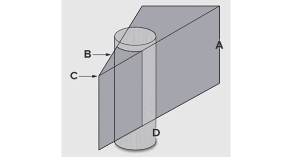

Machining to mill the mould
Protolabs uses an automated CNC machining process to mill the mould for your parts so some part corners will end up with a radius rather than a sharp edge. Part model (A), actual corner radius (B), desired corner geometry (C), tool (D).
Keep an Eye on Radii
Since aluminium moulds are machined using end mills, sharp internal corners are a concern. For that matter, sharp corners on any moulded part tend to create stress and weaken structural integrity. As such, we recommend generous use of radii (rounded edges or vertexes) in part design. For the inside of a 101.6mm by 152.4mm by 50.8mm, for example, it might be best to plan on 6mm radiused corners for a strong part with improved mouldability.
