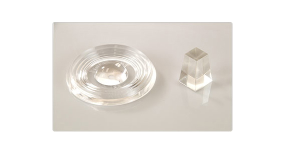

Examples of optical LSR
Optical LSR is a transparent, flexible thermoset material that is replacing glass in many optical applications.

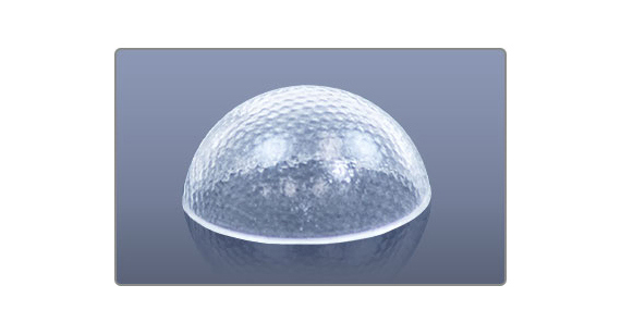

Example of optical LSR part
Its high operating temperature range, UV stability, and flexibility make optical LSR ideal for outdoor applications.
