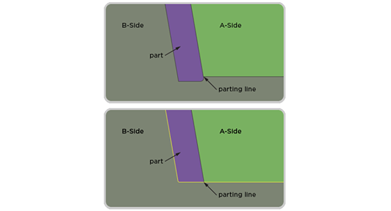

The plastic toy soldier is an obvious example of a design with a challenging parting line, but the issue can come up on simpler parts as well. For example, a straightforward geometric design with radiused or rounded edges can also be problematic. The parting line has to trace the path along which a tangent to the surface is parallel to the direction of mould opening. In Figure 2, the parting line has been placed across an otherwise smooth surface. Any mismatch in mould edges will create a fairly obvious seam, so a parting line in this location would create a need for tighter tolerances and potentially increase milling costs. The increased likelihood of flash could also impact both the cosmetics and functionality of the part, potentially making assembly of finished parts more difficult. If the parting line is instead placed along a sharp edge, the seam would be camouflaged, and the undesired manufacturing, functionality, and cosmetics issues outlined above (see Figure 3) would be avoided.
Illustration of parting lines
Figure 2 (top): Both mould halves formed the parting line, so any mismatch in the mould will leave a seam. We recommend placing the parting line on a sharp edge. Figure 3 (bottom): Both mould halves meet to form the sharp edge of the part.
