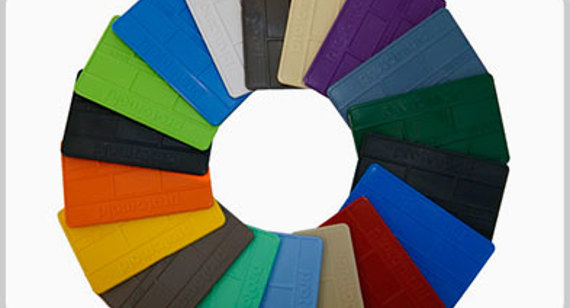

![Injection moulding materials available at Protolabs](/media/5350/design-tip-sample-plaques-fig1a-dec2013.jpg?width=570&height=308&rnd=131281020950770000)
How many different plastics are there for injection moulding?
There are more than 85,000 commercial options for plastic materials listed in material selection databases, and within those, there are 45 polymer families which can be broadly classified into two categories: thermosets and thermoplastics. We primarily focus on the latter category, offering hundreds of stocked engineering-grade thermoplastic resins through our rapid injection moulding service. In addition to our stocked supply of resins, we have the capabilities to support many more customer-supplied resins as well.
Narrowing down that extensive list of materials can sometimes seem like a formidable task, so we’ve prepared a reference guide of injection moulding material recommendations that outlines the benefits and applications of some of our most commonly moulded materials. The right material selection can improve the form, fit and function of your parts—a resolution we can all strive for in the new year.
