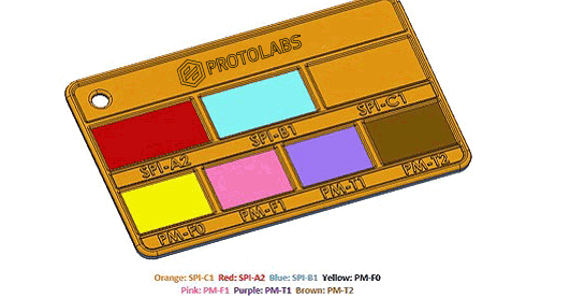

In addition to the seven available surface finishes at Protolabs, you can also obtain a custom finish. With a custom finish, you still have to choose from the seven options, but different finishes can be applied to the A and B sides of the mould. Note that the A side of the mould typically represents the outside of the part and the B side is often the one with the most retention and ejector pins.
We can easily add a custom finish as long as you follow these simple rules:
- Provide a clearly marked, color-coded image (jpg or pdf) of your part indicating the finishes required.
- The part has clearly defined surfaces with a minimum of 0.015 in. of feature height definition, so we can mask off areas for polish or texturing.
- A CAD model is provided with the aforementioned required draft angles for the chosen textures.

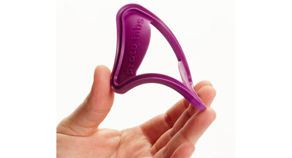

LSR Finishes
Liquid silicone rubber (LSR) is a thermoset material using the same manufacturing methods for producing a mould as earlier discussed, but the moulding process itself is different. LSR moulding uses two liquids mixed together, which are then heat cured in the mould to produce a final part.
Surface finish options for LSR are same as plastic finishes minus the SPI-B1 finish. And like plastic, a custom option that may include two or more of the available finishes is also possible. Unlike plastics, however, LSR is much more forgiving as no ejectors are required for the removal of the parts. All LSR parts are manually pulled from the mould so you don’t need to consider ejection or retention using this process. Another bonus is gating, LSR has extremely shallow gates that are nearly undetectable after moulding.
