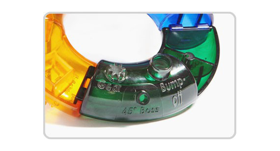

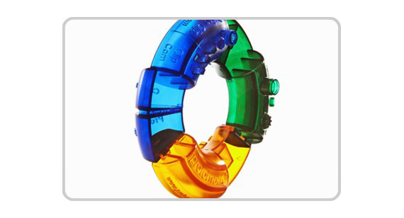

Designing an injection-moulded part with the proper draft, wall thicknesses, radii, and other considerations can be complicated in itself, so when unique features like bayonets and gears are integrated into your geometry, another layer of complexity can arise. If your part requires intricate features, we’re often able to manufacture them through the use of side-actions, sliding shutoffs, pickouts, and other moulding methods. Here are some of the more commonly found complex features, and how they’re achieved.

Bosses
Bosses are essentially raised stud features used to engage fasteners or support features of other parts passing through them. Most bosses are relatively easy to mould; the challenge comes when they are placed on angled surfaces or are quite tall and thin. An angled boss is neither parallel to the mould open/close direction nor the parting line, which forms an undercut that is resolved with a pickout. If you have bosses that are tall and thin with a very high aspect ratio, Protolabs may use a steel core pin to ensure the pin doesn’t break during the moulding process.
Protolabs has grown in capabilities over the years. Upload a model that you think may not be mouldable, and let us surprise you. Our automated quoting system will provide manufacturability analysis and our staff of applications engineers are available at +44 (0) 1952 683047 to discuss complex features, or any other design questions you might have. To help you further visualise and design these features, we created the Torus. It’s a physical design aid that illustrates some of the complex features that your part may require. If you would like a demonstration of the features on the Torus design aid then please contact customer services +44 (0) 1952 683047 to arrange a visit with an account manager.
