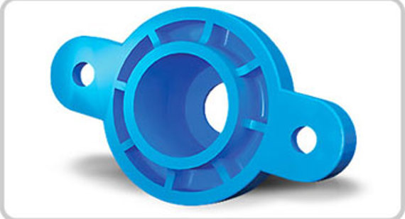

Salt-and-pepper blue colourant mix
Protolabs typically uses a 3-percent salt-and-pepper colourant mix.
Let's switch gears now from additives that modify the mechanical properties of resins to ones that provide cosmetic modifications—colourants. Protolabs offers a limited selection of colourants (about 45) that we can add to a base resin at no additional charge. Thermoplastic base resins primarily consist of black, natural and clear, and colourants can be added to the latter two. We generally employ a 3-percent salt-and-pepper mix, with smaller percentages for transparent resins like polycarbonate. Note that the mix is not an exact colour match; even though a particular material can accept a particular colourant, part colours are approximate. If you upload a 3D CAD model, our ProtoQuote system will automatically indicate which colourants are compatible with which materials.
