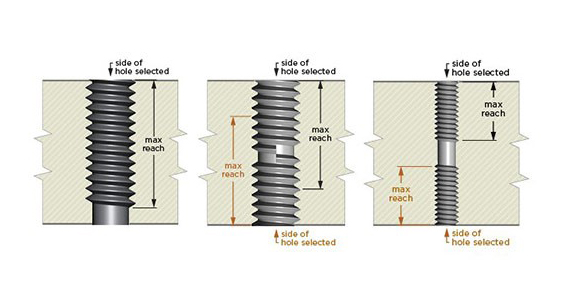

In machining internal threaded holes, a hole may often times be longer than what our threading tools are able to reach. In this case, you have a few options depending on your needs.
- With a long through hole that exceeds the maximum reach, select the hole from the side that you anticipate the screw to be started from as shown in image 1. If your screw is required to pass the entire way through the part, you would also have to pass a tap through the hole (in a secondary process) to complete it.
- You can also select both sides of the feature to be threaded as shown in image 2, but notice the maximum thread depths as they overlap with each other in the hole. This raises concern with threading the features from both sides, because you risk the threads being cross threaded and a screw may not pass all the way through the part cleanly. But as long as the threads don't intersect as seen in image 3, selecting threads from both sides is typically fine.

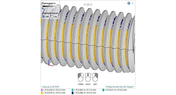

External milled threads are designed into parts much less frequently than internal threads, but nonetheless, can still be machined effectively. External milled threads are produced on the half diameter, and then the part is rotated 180 degrees where the opposing threads are machined in the same way. If you have larger, coarse external threads this does work well—we're able to produce quality ½ in. threads, but you may still want to chase the threads to remove any remaining material or mismatch as the threads are produced in two different machining set-ups.
Smaller external threads such as a #6-32 are much more difficult to produce with a ball or flat end mill as a larger radii would be left in the root of the thread since the pitch is too tight. You would be required to chase the threads with a thread cutting die in order to remove the remaining material. On many parts, a 0.2mm to 0.4mm radius would be left.

Many CAD packages allow you to display threaded features in a few different ways including tap drill, cosmetic thread, or by the major diameter of the thread. We suggest selecting the pilot diameter as long as it is designed at approximately 75 percent of the thread diameter.
The CAD file should then be submitted in a file format other than STL; A neutral file format such as IGES or STEP should be used if possible.
On milled parts that require external threads, you must design the threads on your part as this would then be in our standard milling procedure that uses ball and flat end mills. As stated earlier, this would be not the preferred method for producing threads as you may be required to perform a secondary process of chasing a cutting die over the threads to ensure the parts can be assembled correctly.
