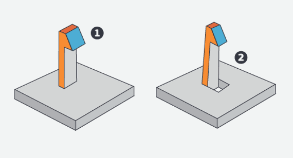

undercuts
Undercuts, such as those shown, can complicate and, in some cases, prevent part ejection, so eliminate them if possible.

Undercuts
Undercut features complicate and, in some cases, prevent part ejection. Get rid of them if you can, but maybe that’s not possible, if, for example, you need a side action, sliding shutoff or pick out. One alternative may be using sliding shutoffs and pass-through cores, or by changing the parting line and draft angles to provide an easier mould build. These reduce tooling costs as you avoid additional pieces to the mould that add to manufacturing costs. In addition to the rise in manufacturing costs of using hand-loaded inserts, this also may have an impact on your piece part price because of longer cycle times and manual mould operation.

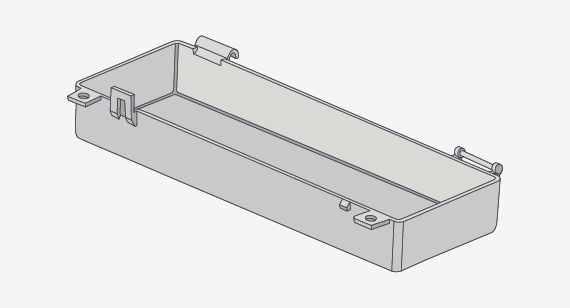

Self-Mating Parts
Maybe you’re designing a snap-together case for some medical components, or two interlocking halves of a portable radio. Why build two mating parts when you can make one? Redesign the snaps so that the halves can be fit together from either direction, thus building a so-called “universal” part. Only one mould is needed, saving production expenses up front. And you can now mould twice as many of one part, instead of half the quantities of two.

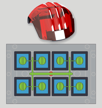

Multi-Cavity and Family Moulds
Maybe you are after a higher volume of parts? You can still achieve high volumes using aluminium tooling with two-, four-, or eight-cavity moulds depending on size and part geometry that can reduce your piece part price, although this would impact your tooling costs.

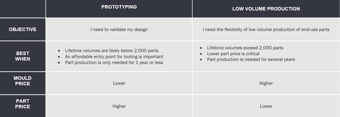

Low Volume Manufacturing
Still another way to reduce moulding costs, depending on your part volumes, is to consider low volume manufacturing. At Protolabs, two injection moulding service options are available (see table below). One is best suited for those who need smaller part quantities, usually associated with prototyping. The other option is a good fit for those who require slightly larger part quantities, typically up to 10,000-plus parts from aluminium moulds. Low volume production can be a great option to manage demand volatility of your parts, reduce total cost of ownership, and leverage cost-efficient bridge tooling.
Self mating part
This is an example of one half of a self-mating part, which fits together in either direction with its other half, building a “universal” part.
multi cavity part
This eight-cavity mould is used for a higher volume of parts (finished part is pictured above the mould illustration).
