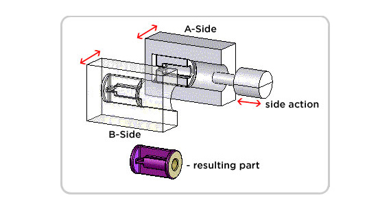

The purpose of side actions is to enable undercut geometry; in other words, to mould parts that could not otherwise be made in a straight-pull mould. In straight-pull injection moulding, the A-side and B-side of the mould open and the completed part can be removed by pulling it straight out of either side. An undercut is a feature in the part design that would prevent the part from releasing out of the mould (part of the mould cavity is undercut in such a way that it grips the moulded part). To release a part whose design includes undercuts, the mould surfaces that create the undercut geometry in the part must be pulled out of the part before it is ejected; otherwise the part will be stuck in the mould. A cam device in the mould is used to pull the side-action mould surfaces away from the undercut features allowing the part to be released from the mould (see Figure 1).
Protolabs produces parts using linear side-actions that move perpendicular to the mould's opening and closing axis. Angle pins (cams) on the A-side guide the cam carriage closer to the mould cavity on the B-side of the mould as the mould closes. When opening the mould, the angle pin pulls the cam carriage away from the cavity and out of the part, allowing the ejector system to advance and push the part off the B-side of the mould.
Currently, Protolabs can use up to four side-actions on a part. These side-actions must be on the exterior parting line of the part, and there are some restrictions to the size of the cam feature and length of travel. These size requirements can be found in our design guidelines. Cams will increase the cost of the mould, but they also increase your design options and reduce secondary operations, thus potentially reducing the cost of your overall project.

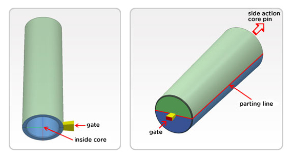

While side-actions are primarily used for forming undercuts such as holes for cables, vent holes for internal fans or slots for assembly, there are some additional applications for them such as making tall, thin parts with a core—a test tube with minimal draft, for instance. If you were to mould a test tube using just a core and cavity (see Figure 2), the mould might require additional draft and wall thickness to permit it to be milled and to allow for ejection. On the other hand, if you lay the test tube down, placing the parting line down the length of the test tube (see Figure 3) and form the inside core of the tube with a side-action, you can eject the part on its side and reduce the required draft. This also allows the gate to be placed on the closed end of the test tube allowing for a uniform fill of the cavity and balanced pressure around the side-action core pin.
