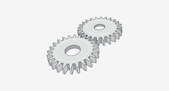

moulded plastic gears illustration of friction and wear
These plastic gears moving together show how a part design can be influenced by the friction and wear that occurs between surfaces interacting with one another, an important element to consider when selecting materials for your moulded parts.
In the snap fit clip example, a wear-resistant polymer such as HDPE might be a good choice, although a relatively lubricious material like acetal could also be a candidate. Both materials have their own unique virtues that should be carefully weighed early in the development process. Yet the product design itself can also play a huge tribological factor. Surfaces that interact with one another should be smooth, lest the miniature peaks and valleys found on rougher surfaces catch and break away with repeated use.
