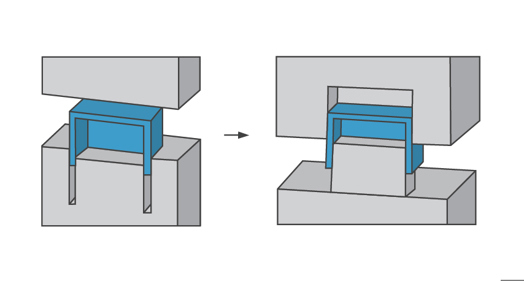

Core-cavity
When you draft, use core-cavity instead of ribs if you can. It allows you to have constant wall thickness rather than walls with a thick base. We can mill moulds with better surface finish and deliver better parts faster.
Tip: This option is faster and less expensive to manufacture.
core cavity
