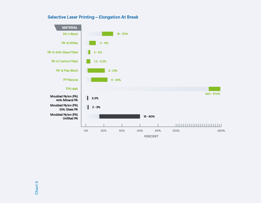

SLS uses thermoplastic powders, predominantly polyamide (PA), to make functional parts that have greater toughness and higher impact strength than parts produced through stereolithography (SL), as well as high HDTs (177°c to 188°c). The trade-offs are that SLS lacks the surface finish and fine feature details available with SL.
Generally, SLS PAs, when compared with the average values of their injection moulded counterparts, have similar HDT values but lower values for the mechanical properties. In a few instances, SLS PAs report properties that document the degree of anisotropism. For a visual comparison of SLS mineral properties, see Chart 4 for heat deflection, Chart 5 for elongation at break and Chart 6 for tensile strength.
PA 11 Black delivers ductility and flexibility with a tensile modulus of 48 MPa and EB of 30% in XY direction, all without sacrificing tensile strength (49 MPa) and temperature resistance (HDT of 188°c). These characteristics make PA 850 a popular general-purpose material and the best solution for making living hinges for limited trials. When compared to the averages for injection-moulded PA 11, PA 11 Black has a higher HDT (188°c vs 140°c) with similar tensile strength and stiffness. However, its EB, while the highest of all AM plastics, is 60% less than that for a moulded PA 11. Another factor that distinguishes PA 11 Black is its uniform, deep-black colour. Black has high contrast, which makes features pop standout, and it hides dirt, grease and grime. Black is also desirable for optical applications due to low reflectivity.
PA 12 White is a balanced, economical, go-to material for general-purpose applications. PA 12 White is stiffer than PA 11 black (tensile modulus of 1650 MPa vs 1560 MPa) and has a similar tensile strength (48 MPa vs 42 - 48 MPa). While its EB is less than half that of PA 11 black, at 18% it’s still one of the top performers in terms of ductility. PA 12 White is loosely comparable to the average properties for an injection moulded PA 12. It has similar stiffness but roughly half the tensile strength and EB. However, its HDT is significantly higher: 188°c vs. 138°c.
PA 12 40% Glass Filled is a polyamide powder loaded with glass spheres that make it stiff and dimensionally stable. However, the glass filler makes it brittle, significantly decreasing impact and tensile strengths. The glass spheres also make PA 12 40% Glass Filled parts much heavier than those made with any other AM material. PA 12 40% Glass Filled is a good choice when stiffness and temperature resistance are required.
PA 12 Carbon Filled is an anthracite grey nylon characterised by extreme stiffness and high temperature resistance, coupled with electric conductivity properties and light weight. Carbon-fibre filler provides different mechanical properties based on the considered three axis direction.
PA 12 Flex Black is a black/ anthracite nylon characterised by excellent flexibility and impact resistance. PA 12 Flex black combines positive properties of PA12 and PP. Strength and stiffness is similar to PA 12 with tensile strength of 48MPa. The elongation is comparable to that of unfilled PP with EB of 2-21% vs. 6-24%
TPU-88A is a thermoplastic polyurethane (TPU) that combines rubber-like elasticity and elongation with good abrasion and impact resistance. EB for TPU-88A is 450-570%
