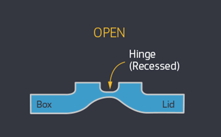

Now, even if you haven’t heard the name before, you probably know what a living hinge is. They’re thin, flexible hinges that are made of the same material as the pieces it connects – think of the lid of a box of mints or even the middle of those fold-up, disposable spoons you get when you buy a yogurt.
They’re great little pieces of design – cheap, easy to make and highly effective – but while injection moulding can easily produce living hinges that have a long, reliable lifespan on finished products, it can be a little trickier to get them to work when you’re 3D printing up prototypes.
While it is possible to create robust and functional living hinges with technologies like selective laser sintering and multi jet fusion, you need to take a little more care during the design stage. This may even require that the hinge be designed one way during the prototyping stage, and then redesigned before moving to injection moulding.

The first principle to keep in mind is that the hinge always needs to be the weakest area of the part. If the living hinge is roughly the same thickness as the rest of the geometry, then the part will distort and flex when you’re attempting to use the hinge – not ideal.
insight on 3d printed living hinges
Next up, you need to bear in mind that the force needed to bend a hinge is proportional not only to the thickness of the hinge, but also its width. To make things a little easier, then, you can think about modifying one big hinge into several smaller ones. Rather than have a single 20mm hinge, you could have, say, three 5mm ones with gaps between them. That reduced width means you need less force to operate the hinge and therefore less stress is placed on the clasps, snaps, and the geometry as a whole.
living hinge on 3d printed parts
Cutting this down is important because living hinges are under constant stress when in use. One side of the hinge is going to be under compression, while the other side will be under tension. As well as making them as narrow as possible, we also want to make them as thin as possible. If you’re 3D printing a living hinge, you generally want it to be the minimum feature size for the technology you’re using.
