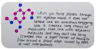

When you force plastic through an injection mould, it does not behave like an amorphous easygoing blob. It creates long chains of molecules that link with adjacent molecules and they don’t like being cramped into a tight corner or having to flow around a sharp edge caused by posts or wall intersections.
corners on im parts
It means that the material might not reach every nook and cranny in your mould cavity and you are left with some gaps.

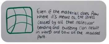

Even if the material does flow where it’s meant to, the stress caused by all that molecular bending and twisting can result in warp and bow on the moulded part.

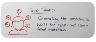

There are two things that you can do. Generally, the problem is worse for glass- and fibre-filled materials because their greater strength and molecular integrity make them less likely to go with the flow than unfilled plastics.

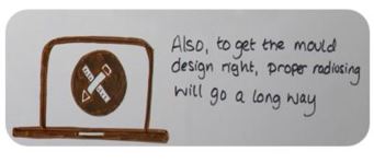

The second one is to get the mould design right, proper radiusing will go a long way to avoiding this.

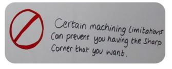

You also need to realise that there are certain machining limitations that can prevent you having the sharp corner that you want. The internal corners in any mould cavity can’t be smaller than the end mill used to machine them.
corners of im parts - what to do
Now you can get around this by using other manufacturing methods such as electrical discharge machining, but this is slow and will cost you more money. Plus of course you run the risk of the complications that I’ve already talked about when it comes to the injection moulding itself.

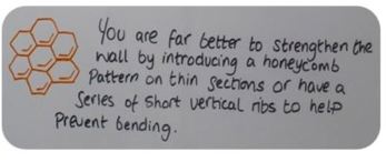

Moving on, I mentioned about beefing up your walls to help you get sharper corners… well it’s not just about making them thicker, because this can lead to sink, shrink and bubbles.
You are far better to strengthen the wall by introducing a honeycomb pattern on thin sections or have a series of short vertical ribs to help prevent bending.
